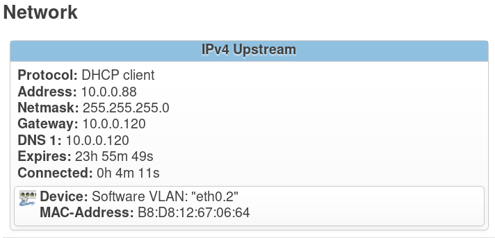

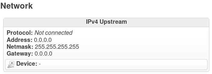

loaded the firmware file labeled 20190204.bin
added lines below to /etc/config/network
config switch_vlan
option device 'switch0'
option vlan '2'
option ports '0 6t'
rebooted then
config switch_vlan
option vlan '2'
option ports '0 6t'
rebooted then
- with lines added to /etc/config/network

- without lines added to /etc/config/network
- NotConn.png (23.02 KiB) Viewed 33386 times
