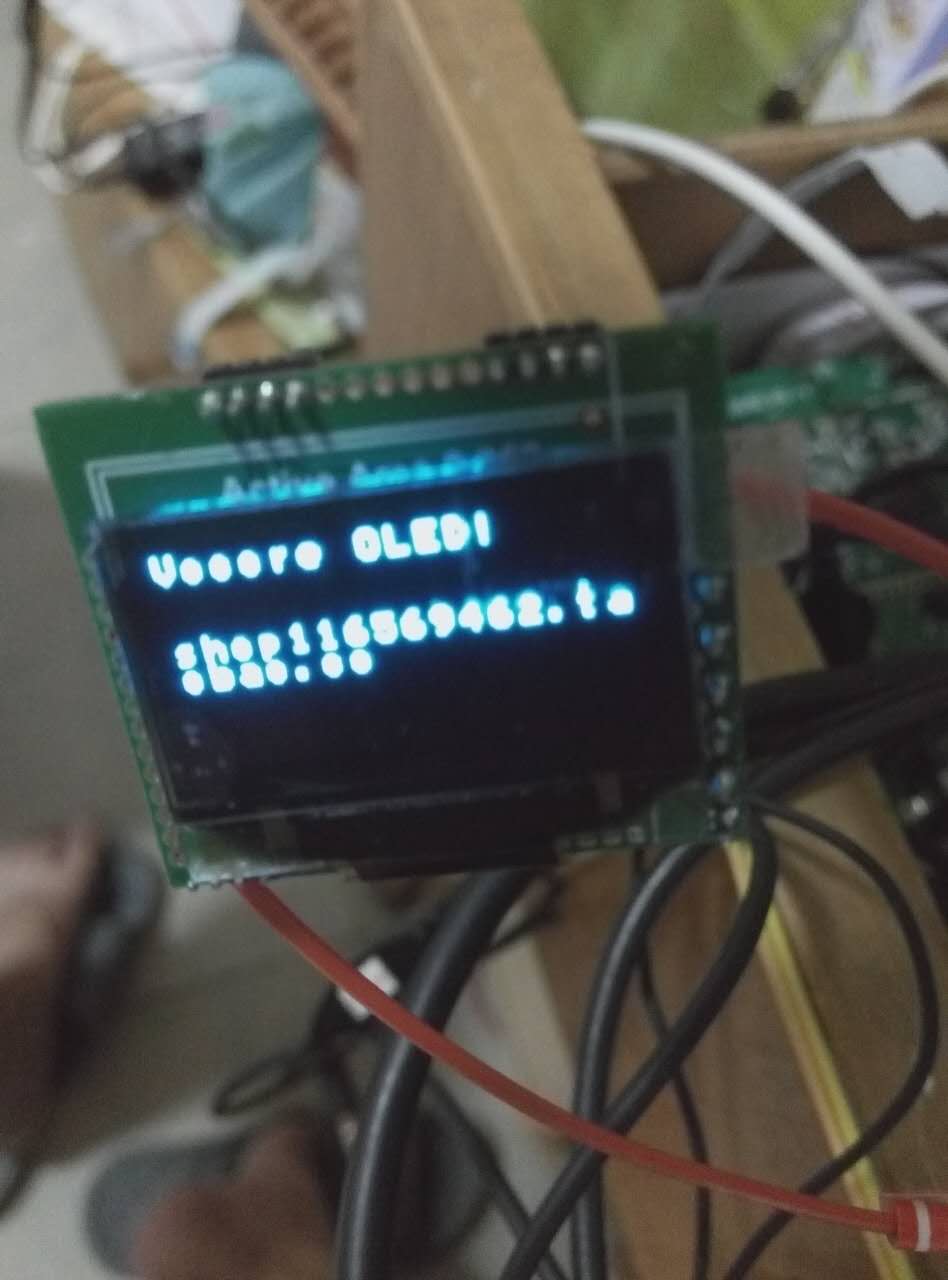

Is everyone interested in this?

haha,I have done it~~

where is the file font5x8.h in your topic. thanks for help~~

soso wrote:where is the file font5x8.h in your topic. thanks for help~~
I think that is a font library in array 5x8, if you did any embedded app for such as 8051, should be easy for you :)
If not, have to wait...

Yeah it is just the standard font thing. you can search google for font5x8.h and get the answer.
But here it is.
int font_cols = 5;
