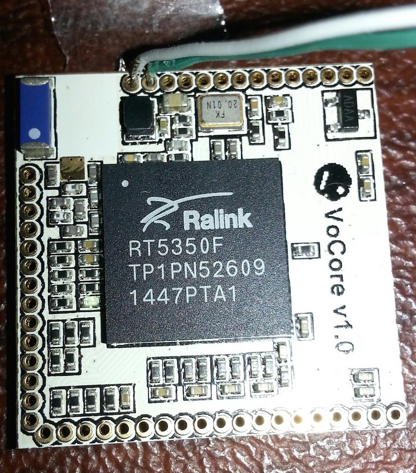

I attached the two leads from the USB cable to the first two holes at the 8:00 position on the board, and sure enough when I connect the cable the led lights up. Right on! Now I start checking the WIFI networks listed in my WIFI devices, and the little vocore doesn't show up in any of them. All are with a foot of the vocore.
Am I holding my mouth wrong when I connect or what?

Another question: I used two of the power connector holes. There are four. Two 3.5V and two Gnd connectors.
a) Did I connect them correctly (See photo)? Should I have split out and used both 3.5V holes and both Gnd holes?
b) Why are there two sets of holes?

5V and GND is enough.
Once it connect to UART2TTL, please send the log.
It is weird, if LED keep lighting, the VoCore is failed to boot at all.

I changed the USB cable I was using to a new one, and the vocore powered up and performed as advertised. The problem was the cable, not the vocore.
Thank you for your advice.
