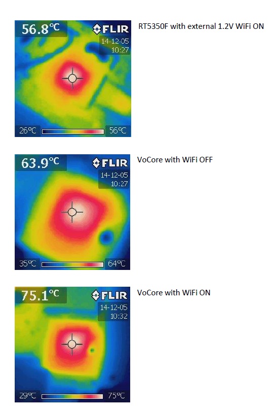

Hi,
So I did a comparison between the VoCore using internal 1.2V regulator and a Router with RT5350F chip using external 1.2V regulator.
There is a huge difference.
See attached images taken with a FLIR.
- FLIR Images
- FLIR Images.jpg (79.05 KiB) Viewed 60144 times
