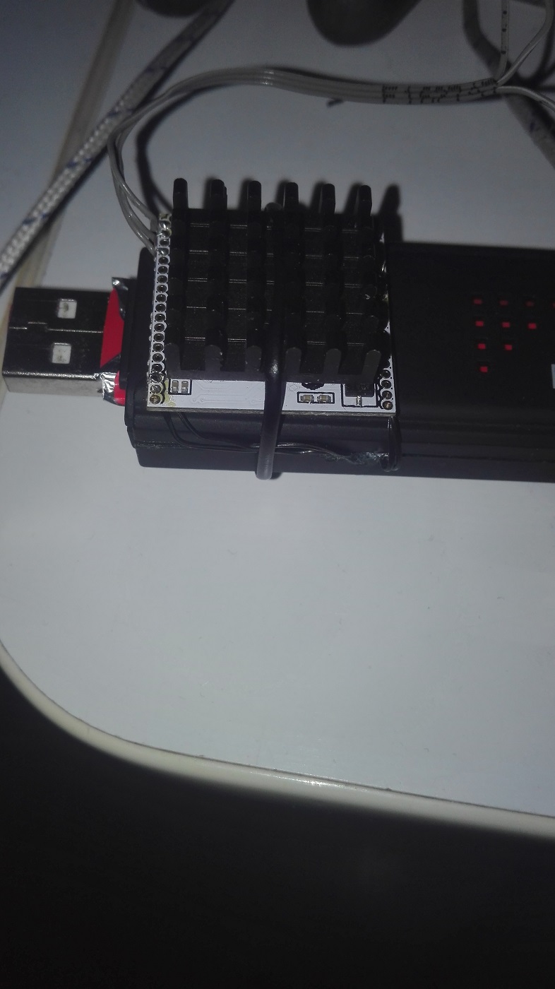

Small hole in the actual RTLSDR dongle. The wires directly go to the USB dongle. A power supply powers both the dongle and the VoCore
VoCore 3.jpg (156.82 KiB) Viewed 60693 times

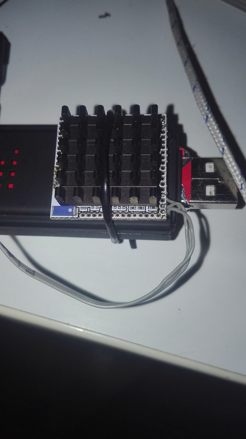

ditto
VoCore 2.jpg (195.71 KiB) Viewed 60693 times

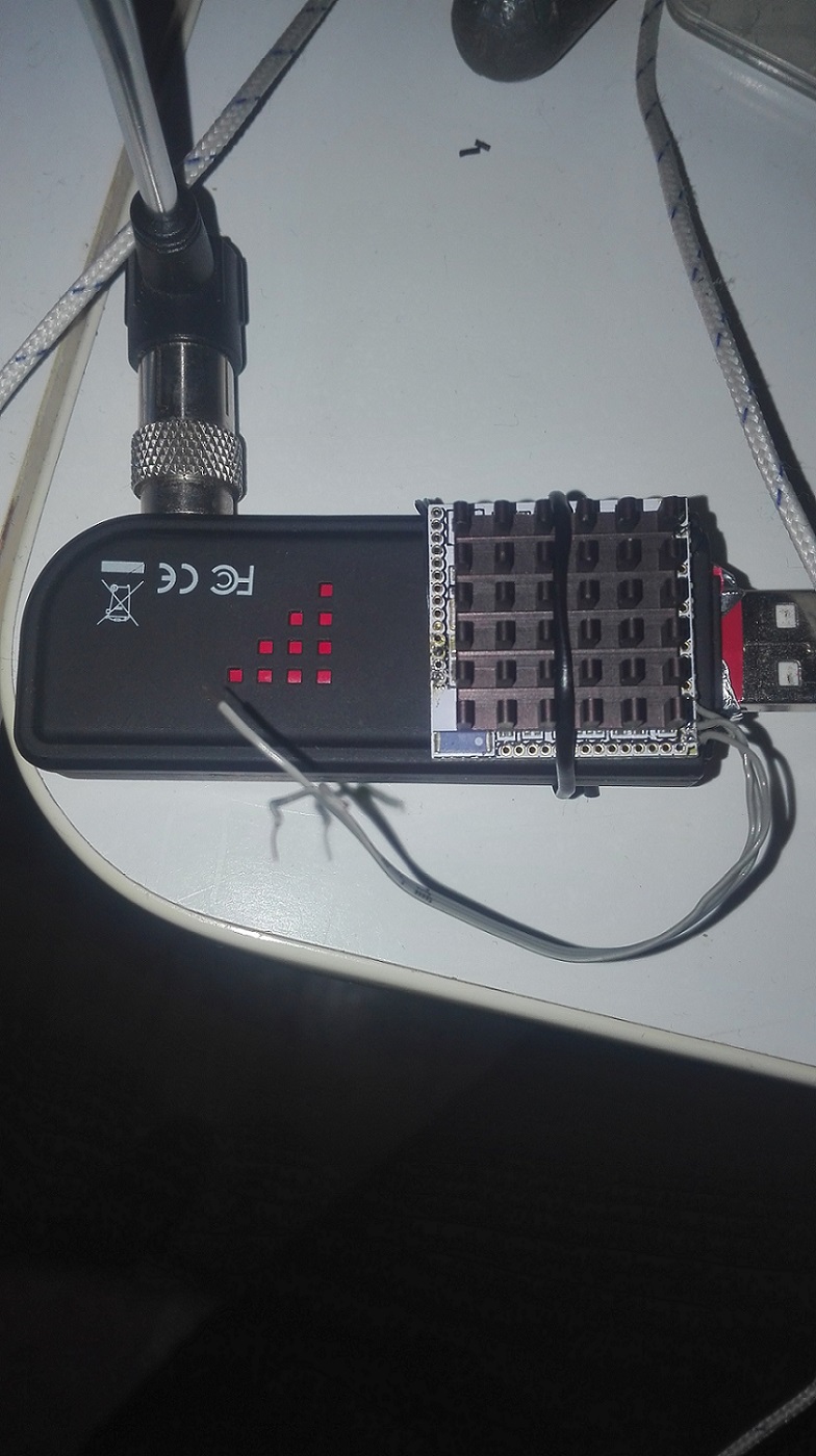

The assembled dongle with antenna. The three random wires are the serial console
VoCore 1.jpg (236.74 KiB) Viewed 60693 times
