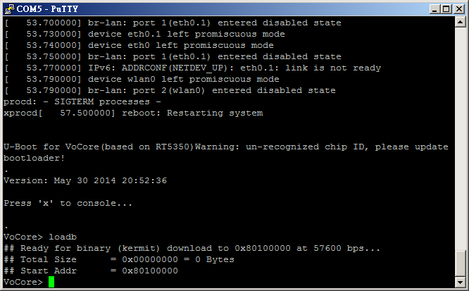

I had download vocore firmware form: http://vonger.cn/?p=1637
And I followed Upload Firmware topic: http://vocore.io/wiki/index/id:14
to upload firmware, after few minutes, my NB network was been disconnected, I think step 1 of upper link was done.

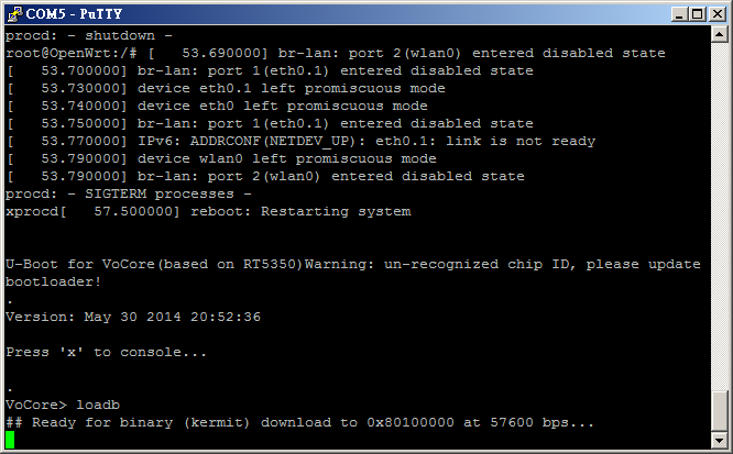

So I had vocore powering down and powering up, pressing x for entering uboot console, then key in "loadb", screenshot is below:
loadb
Then I press down CTRL, \ key, then press C, the screenshot is below:
CTRL+\ then press C
I don't know how to do the following step, could anybody help me?

Kermit is a way of transferring binary data over the serial adapter. Once you issue the loadm command, the VoCore is waiting for you to send it the firmware image using Kermit.
There are many programs that will allow you to do that. In the tutorial it tells you to use C-Kermit, but that doesn't run on Windows AFAIK. See https://en.wikipedia.org/wiki/Kermit_%28protocol%29.
Re: How to finish firmware upload
Fri Dec 12, 2014 12:52 pm
http://kermit.wwarthen.com/Download.htm
This kermit for windows might work.
