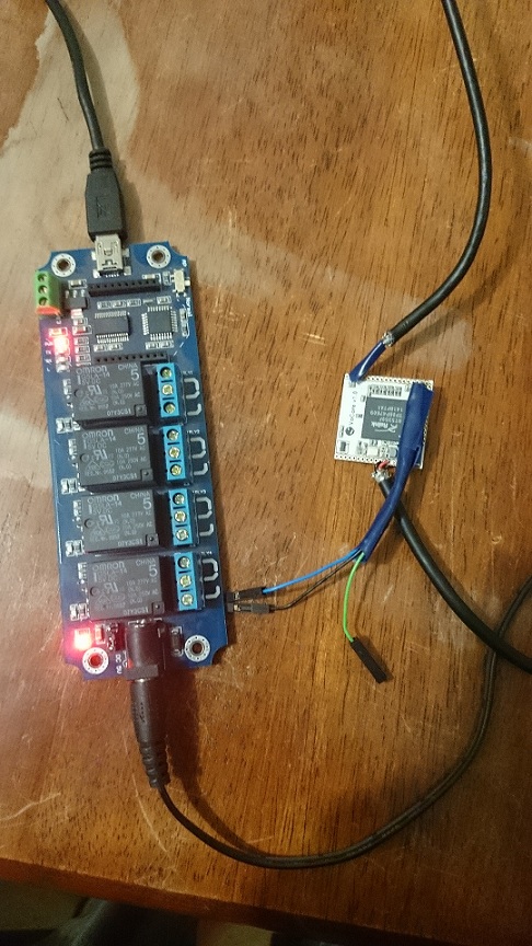

Hi,
I have both a VoCore and a 4 channel USB relay board which is a FT232RL USB to UART chip with 4 relays.
I have soldered up the two wires for the USB and both the VoCore and Relay board are both running from a 5V wall wart.
The VoCore starts and connects to my WiFi no worries and I can SSH into it however it does not appear to see the USB-Serial chip even with the
kmod-usb-serial and kmod-usb-serial-ftdi modules installed.
I have attached a picture of the setup (excuse the awful soldering)
Connections have been checked with a multimeter and seem OK.
The chip is a FT232RL USB to UART.
Any suggestions?

dark_avenger
Posts: 4
Joined: Wed Feb 11, 2015 10:55 am
Re: VoCore -> USB Relay Board
Thu Feb 12, 2015 8:48 am
Forgot to attach picture
Ruphobia
Posts: 18
Joined: Fri Jan 30, 2015 4:07 pm
Thu Feb 12, 2015 6:29 pm
please post response from the following commands:
lsmod
ls /dev/ttyU*
Thanks

Ruphobia
Posts: 18
Fri Feb 13, 2015 4:59 pm
Everything looks correct in your module list:
usb_common 1160 1 usbcore
usbcore 107099 6 ftdi_sio
usbserial 18295 1 ftdi_sio
So at least your modules are loading properly. I suspect it's a wiring issue, i noticed there's no ground on the USB cable going to the relay board. I would start by wiring the ground on that USB cable to a ground pin on the VoCore.
If it still doesn't work. Try adding +5V on the USB cable as well.
You should see "/dev/ttyUSB0" when you do ls /dev/ttyU* when it is working.
You can then talk to it by doing:
screen /dev/ttyUSB0 115200 (change the baud rate to match the relay board if its not 115200)
Thanks
dark_avenger
Posts: 4
Sun Feb 15, 2015 6:52 am
I'll give it a shot. The DC jack is wired back to the same PSU but it's quite possible the USB -> Serial chip is powered from the USB port.
I'll let you know how I get on.
Thank you :)
