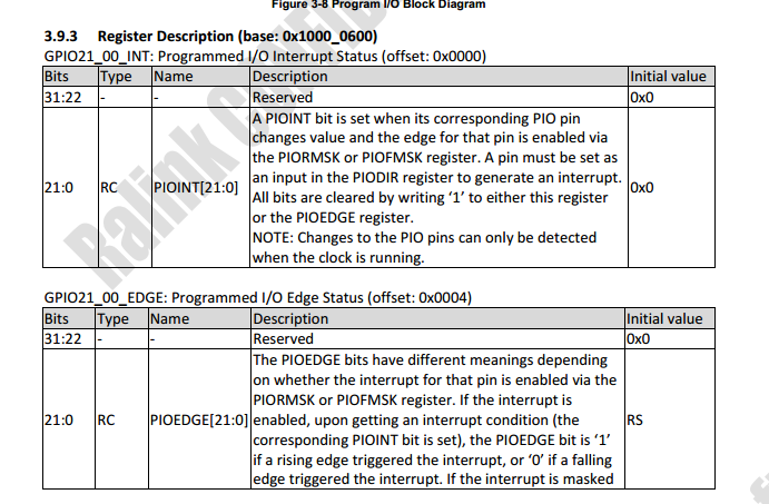

Yes, but the Problem is, that I don understand why he use the addres 0x10000000. I take a look into the Datasheet and see that the addres of the PIO Controller is 0x10000600. :(

@ Peter:
Yes I know this technique.
As you can see on my screenshot the PIO Base-Register is 0x1000_0600. So why he use 0x1000_0000.
I want understand my Problem and not the single solution.
Edit:
During writing these text, the solution of the Problem appears in my head..
I will write a full solution for GPIO + Explanation when I´m back at home!

Kampi wrote:As you can see on my screenshot the PIO Base-Register is 0x1000_0600. So why he use 0x1000_0000.
The expression Pyrofer uses to access the I/O control registers adds an offset to that base address to calculate the address of the particular register that is to be addressed, as shown in Pyrofer's code I posted previously. I don't know why Pyrofer chose to map the whole address range instead of just the PIO registers, but perhaps he wanted a more general solution which gave him access to other registers too.

I think you must access the PIO Controller over Palmbus.
Take a look at the Device Tree:
https://dev.openwrt.org/browser/trunk/t ... ?rev=36246
You can see, that the GPIO-Controller is a child of the Palmbus. So I think you must access the Palmbus (over address 0x10000000) and then you can access the GPIO-Controller.
You see the Startaddress of gpio0 ist 0x600 (Offset to the Palmbus).
If you want access this peripheral components you have to address the Bus and with a Offsetaddress from the Bus you can access peripheral components.
