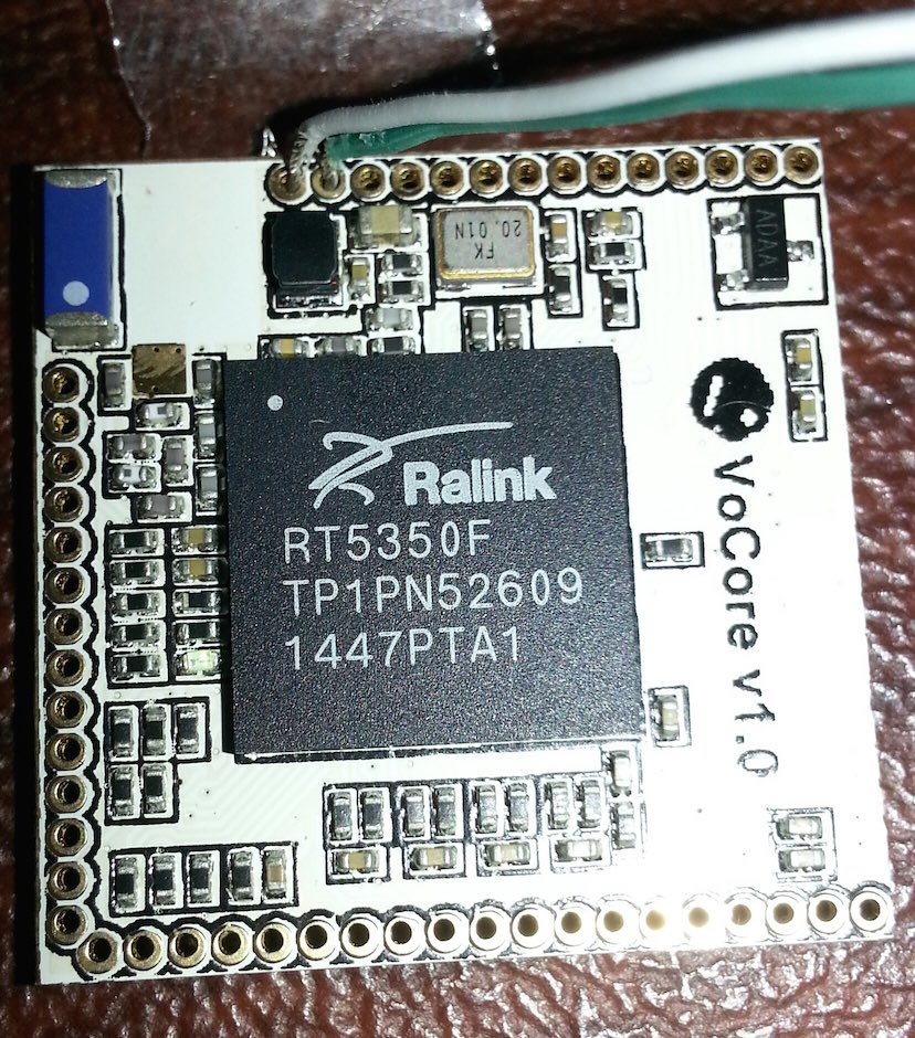

What am I doing wrong?
I attached the two leads from the USB cable to the first two holes at the 8:00 position on the board, and sure enough when I connect the cable the led lights up. Right on! Now I start checking the WIFI networks listed in my WIFI devices, and the little vocore doesn't show up in any of them. All are with a foot of the vocore.
Am I holding my mouth wrong when I connect or what?
Notice USB wires connected to first two holes.

1. first check if LED is lighting correctly.
2. check if your USB power is stable.
3. connect to UART to TTL, check the boot log.

Another question: I used two of the power connector holes. There are four. Two 3.5V and two Gnd connectors.
a) Did I connect them correctly (See photo)? Should I have split out and used both 3.5V holes and both Gnd holes?
b) Why are there two sets of holes?

5V and GND is enough.
Once it connect to UART2TTL, please send the log.
It is weird, if LED keep lighting, the VoCore is failed to boot at all.
