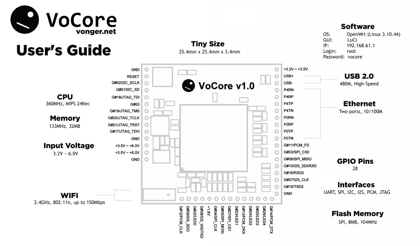

Hi.
Does anyone know how to soldering USB female connector ? I can see the USB Data + /- and GND and +3.2V.
Do I need a 5V regulator ?
Re: How to soldering USB connector
Posted: Wed Apr 27, 2016 1:05 pm
by brad
Yes, you need a 5v supply. If you power the vocore with 5v you can just use that for USB, or use a powered hub.
Posted: Wed Apr 27, 2016 11:56 pm
by dongjoon kim
Thanks...
I will use lithium battery for power supply and also use 5V regulator for power input on USB connector (using any usb devices).
Do I need anything else forgotten ?
