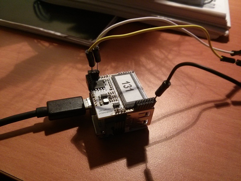

I'm on a Mac; how can I connect to VoCore over UART TTL?

I looked at the final VoCore V1.0 schematics and they are different from the blog post above.
Which ones are the correct pins?
http://vonger.cn/upload/VoCore.v1.0.pcb.pdf
TXD2 and RXD2 are the 2nd and 4th pin.
http://vonger.cn/vocore/VoCore.v1.0.sch.pdf
TXD2 and RXD2 are the 2nd and 5th pin.
I am not an expert in schematics and PCBs, but I am confused.
Re: How to connect over UART?
Posted: Fri Nov 28, 2014 10:11 am
by sistemasorp
The correct ones are in this manual:
http://vonger.cn/upload/vocore.manual.pdf
I have had to solder the pins to access to the uart console when I changed the wifi configuration.
