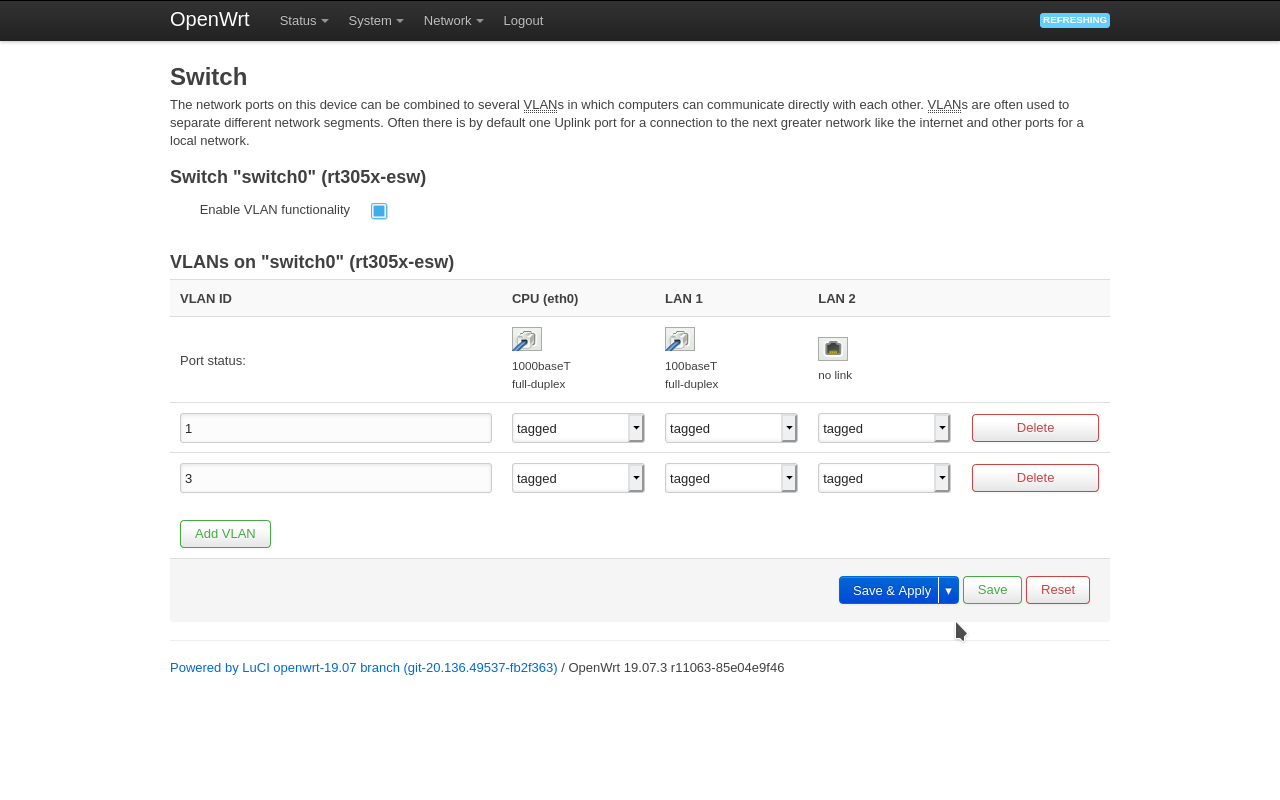

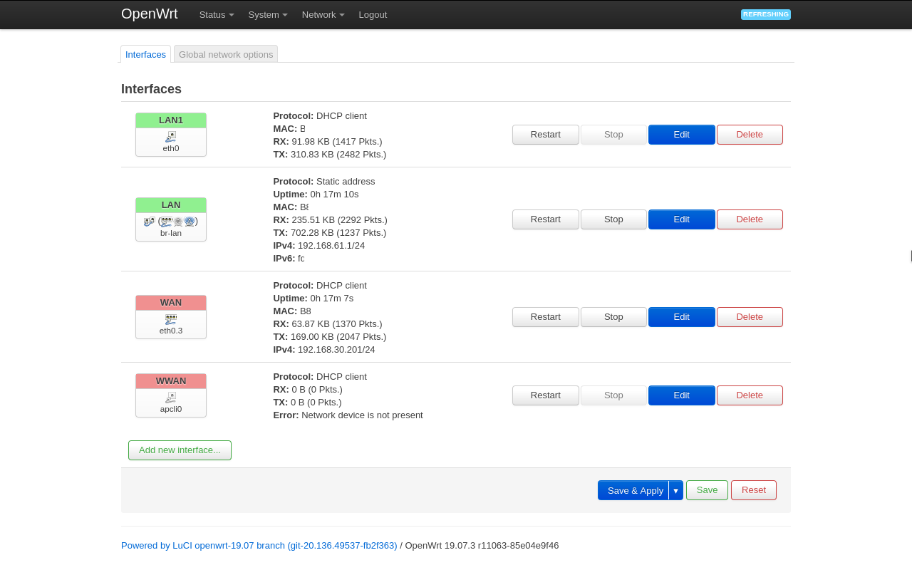

What I got now:
The virtual LAN-port "VLAN3" gets the ip address from router (192.168.30.201) as shown in pic 0001.
But "eth0" on "VLAN0" is not receiving an ip from DHCP. But the DHCP is there! I can plug in the cable to another device and the ip address is associated.
Please,if enyone can guide me through the config process it would be nice. I am afraid to lock me out or brick the device by playing around with the config parameters......
