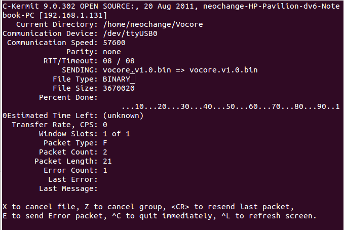

Well I have downloaded a Vocore firmware from http://vonger.cn/upload/ ( the vocore.v1.0.bin )
and I am trying to upload the bin file to the board throught kermit. I open a terminal to the board and execute the command loadb as the tutorial says.
Then I use minicom to upload the file to the board with kermit. I tried to use kermit directly but if I press control-\ and the C nothing happens. When I try to upload the file everything seems OK but I got the error:
And this is the Kermit log while it is trying to upload the file:
After that, the error count raise and the communication interrupts.

The UART connection is not stable, so it failed, do you have a dock? so you can connect to ethernet and download by tftp.

The uart connection was not stable because I "forgot" ( not really forgot, i didn't know it) to connect the ground cable to the board through the UART port. Log session looked good but when I tried to upload the file, it was failing all times. With the GND cable connected the transmission was OK and I could upload the binary.
