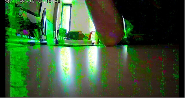

After some time of using VoCam camera, a green segments started to appear in the H.264 video stream. See attached image. In higher resolutions, this error is more visible. This happens only in H.264 stream, MJPG stream is not affected at all.

if power off it wait one minute then connect, is it same result?

Yes, this "Matrix" noise appears every time since the problem started occur.

I see, I will contact the chip FAE, maybe it is firmware issue.
Re: Damaged H.264 stream
Sun Apr 05, 2020 1:08 pm
It should be some key frame loss package. If mjpeg works, that means hardware should be normal, please try the source code in SDK to record some h264 video from the camera, check if the problem is still there.
