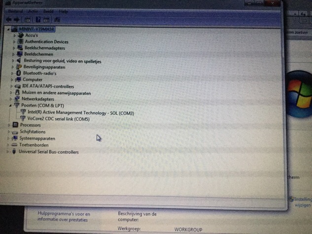

Then plug in the VoCore2 and let Windows fail installing the driver, go to Devices and Printers and right click on the "GD32 Virtual ComPort" icon and select Properties. On the Hardware Tab click the Properties button and then the change settings button. On the Driver Tab
click on the Update Driver button and take the browse my computer option and navigate to the folder where the usb_device.inf file is, click OK then click next. Tell Windows to "Install this driver anyway".
When it finishes installing the driver the name in Devices and Printers should change to "VoCore2 CDC serial link", if you don't like this name it is set in the usb_device.inf file, change it. Note what COM port it is assigned to.
Now you should be able to use a serial session in PuTTY with this COM port (don't forget to set the baud rate)

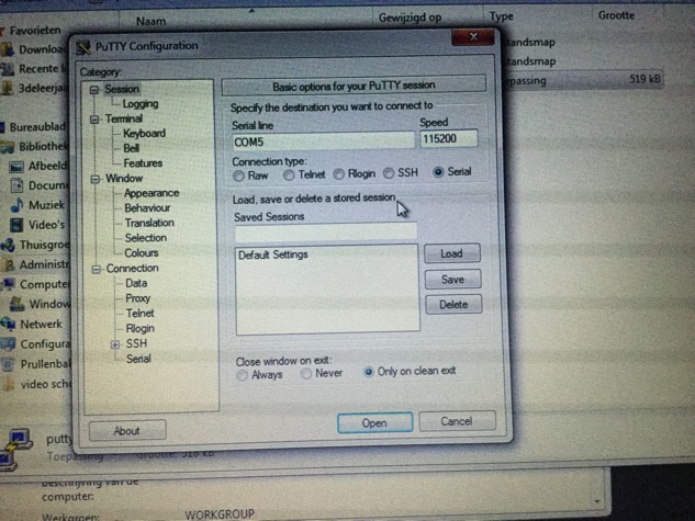

It worked for me with the inf file, I have it under com5
Can't connect to putty. Not sure what settings I need.
Can anyone help, I get a black screen and I can't type and see nothing happening when I try it with these settings.

Did you hit [Enter] when you get the black screen? I'm old school the first thing I do on a black screen is hit enter half a dozen times, just instinct.
If you set the baud rate to 115200, PuTTY's default settings should work. Just in case they are 8 bit chars, no parity, 1 stop bit, XON/XOFF flow control.
Note: Edit on 20170105 - corrected PuTTY default flow control setting but either XON/XOFF or none will work.

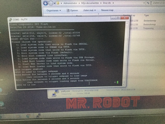

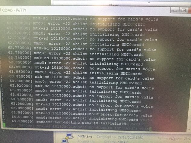

Okay I get this now with the error (flow control was xon/xoff instead of off)
I quickly typed reboot and see this very short. Then the error again. What should I do now?

I misspoke, PuTTY's default setting for flow control is XON/XOFF but the connection will work with either XON/XOFF or none.
You have at least a couple of ways to go from here but here is what I think is the easiest:
You will need the 20161224 image, go ahead and download it to your computer put it somewhere easy to find.
First we will put the VoCore2 back like it was when you got it
1. Close PuTTY
2. Unplug the VoCore2
3. Start PuTTY, get all the settings correct, Serial Connection, the COM port your VoCore2 shows up on, Speed 115200, Put your cursor over the "Open" button but DON'T click the "Open" button to start the connection yet.
4. Plug in the VoCore2, watch for the led to light
5. Click the "Open" button
6. Get ready to type "f" and [Enter] but don't do it yet
7. When the garbage starts type "f" and [Enter]. (Don't put in the quotes just type the letter f and press the enter key)
8. Wait a few seconds, if the counter on the left of the console is past 10 you have waited long enough
9. The garbage continues but blindly type "rmmod mtk-sd" and press [Enter]
10. The garbage should stop but if it doesn't repeat step 9, it is hard to type with the garbage in your face.
11. Type firstboot -y, press [Enter] (you can actually do this with the garbage spewing but it is easier to be sure you get right if you have to garbage off)
12. You should see a message telling you mtdblock6 will be erased on the next mount.
12. Close PuTTY, unplug the VoCore2
Your VoCore2 will be reset to the original configuration the next time you plug it in. The main thing we want is the Luci web interface. So now we will load the latest image. It doesn't spew garbage on the console and it is easier to configure for the STA+AP WiFi:
1. Plug the VoCore2 back in
2. Wait until the VoCore2 AP is available, it takes a couple of minutes, I use an app on my phone to watch for it to appear.
3. Connect to the AP with your computer
4. Open your web browser and point it at 192.168.1.1 (I think you are using the image with this IP but some later ones use 192.168.61.1 try it if 192.168.1.1 doesn't work)
5.  Login to Luci using the password "vocore"
6. Go to System->Backup/Flash Firmware
7. Use the Choose File button in the "Flash new firmware image" section.  This is at the bottom of the page, don't use the one in the Backup/Restore section!
8. Click the "Flash image" button.
9. On the next screen it should tell you the checksum is 2a6b06ee7ec7b3fa6fd3e9eeb5c83531, if this is correct click the Proceed Button.
In a few minutes the VoCore2 AP will go away then a few minutes later come back up. You are now running the latest image and probably want to do Setup AP + STA Mode on this page.
