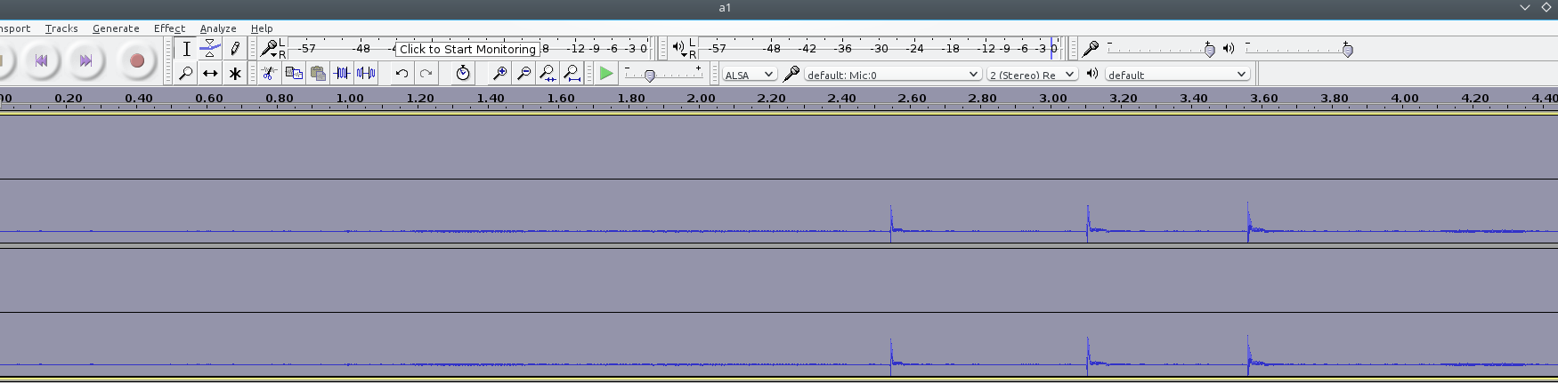

Thanks, disabling wifi helped to get rid off most of the noise, but there is still significant noise from other parts. You "hear" the device when e.g. writing to SD card. Besides, there is very big DC bias in captured sound (see attachment). So I think, there are two distinct issues: crosstalks and bias. I wonder if at least one of them can be solved by codec configuration? Or is it in hardware connection, pre-amplifier settings and so? I'm not experienced with audio stuff much...
