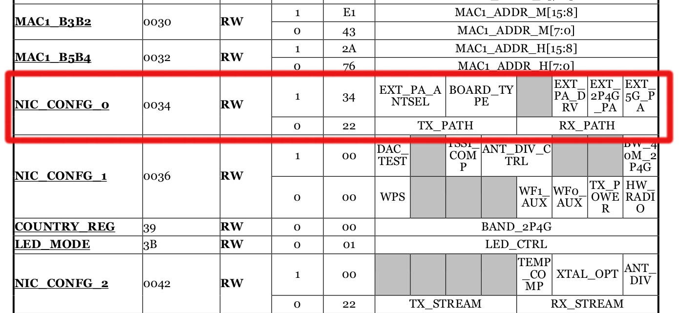

I too thought about that feature and have found EEPROM Base address in mt7628.pdf http://vonger.cn/misc/vocore2/datasheet.zip:
it's a right way?

That config is used to enable 1 antenna or 2 antennas, can not control which one to enable.
