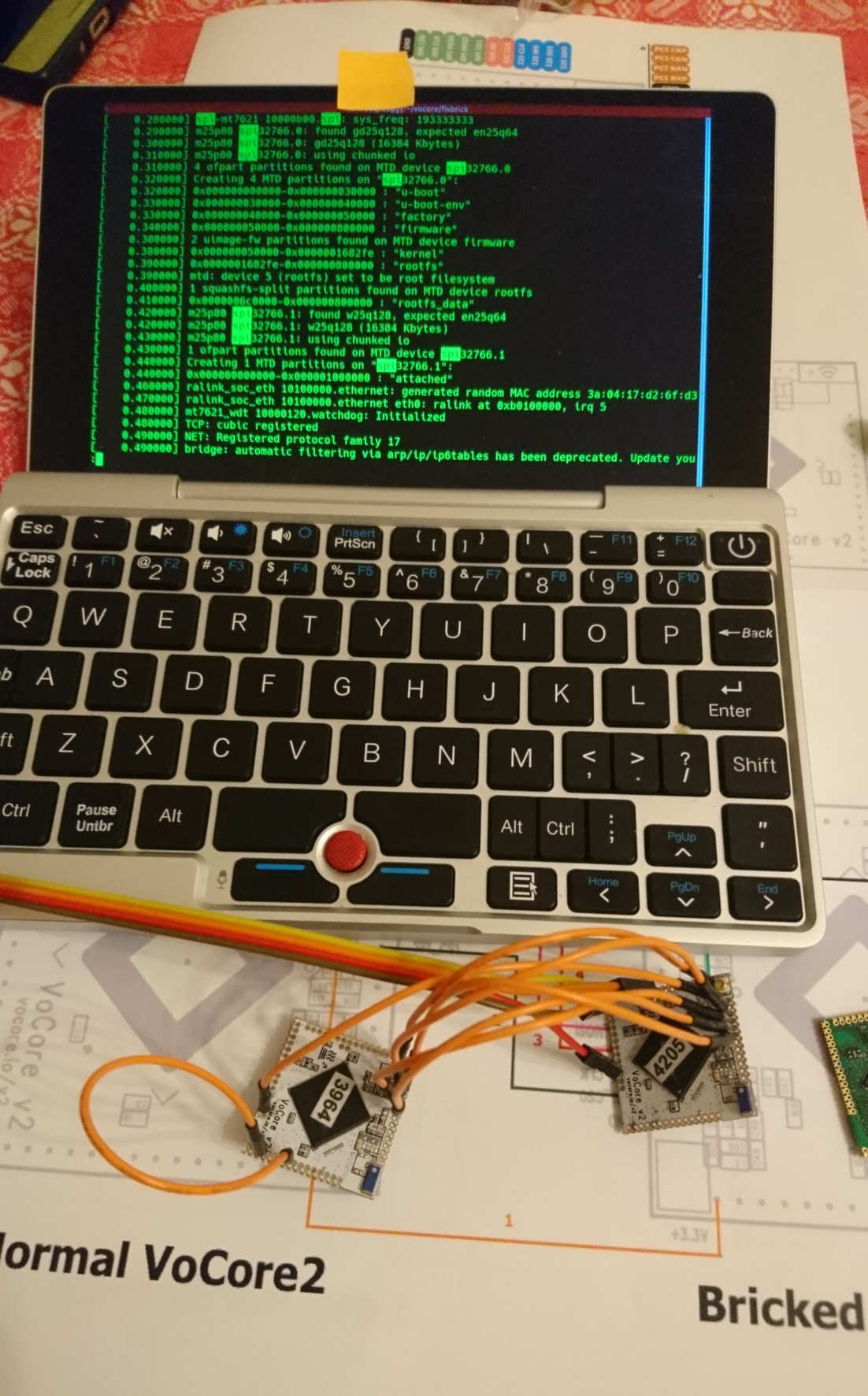

The flash id did not recognize correctly, so vocore do not attach it with correct size(only make it to 32KB)
Do you keep the bricked VoCore2 into reset mode?(connect RST pin to GND)
And cables might not correct, looks like some bit is lost, so it can not get correct flash chip id caused it can not show correct size.
If it is possible, take a photo of your connection.

It worked!!!
lots of orange cables
Thank you for making me try again, I forgot cable 1, 3V3 m( Had to do a few reboots, but then it showed the full size:
[    0.420000] m25p80 spi32766.1: found w25q128, expected en25q64
[    0.420000] m25p80 spi32766.1: w25q128 (16384 Kbytes)
[    0.430000] m25p80 spi32766.1: using chunked io
[    0.430000] 1 ofpart partitions found on MTD device spi32766.1
[    0.440000] Creating 1 MTD partitions on "spi32766.1":
[    0.440000] 0x000000000000-0x000001000000 : "attached"
and I could flash
root@vocore2:/# mtd -e attached write /tmp/ultimate.16m.img attached
Unlocking attached ...
Erasing attached ...
Writing from /tmp/ultimate.16m.img to attached ...
root@vocore2:/# md5sum /tmp/ultimate.16m.img
f4c527a1e563d0ad7ef9ab0b5e0b35c6  /tmp/ultimate.16m.img
Unfortunately the brick stays a brick - no LED on power and no output in terminal :(
I guess that one has to rest in pieces...
