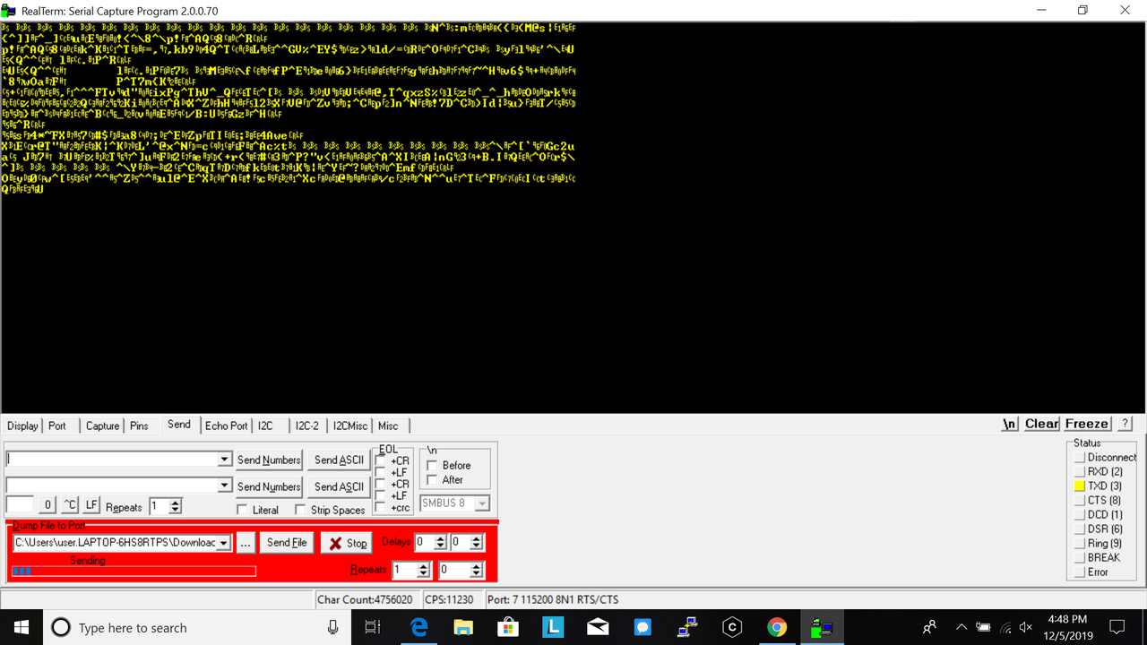

Hello gents,
I'm using VoCore2 running OpenWrt, and I did install a package this way:
kmod install kmod-usb-net --force-depends
After that the rebooting never ends :blush:
Thanks in advance and here is the terminal output:

Re: Installed a Package Using (–force-depends), Then Got Stu
Thu Dec 05, 2019 2:23 pm
After seeing (## Ready for binary (kermit) download to 0x80100000 at 115200 bps...)
I sent the binary (Firmware(64MB+128MB, 20190802) using RealTerm, but nothing happened after that!
Did I sent it the correct way? is it the correct binary? did I miss something?
(While uploading the binary)

Check vocore.io/v2.html, I can success download by using teraterm. teraterm File -> Send -> Kermit that way works well, and it will show a progress bar.
Also once I write a tool, I will update my blog later, you can use the command tool send file by kermit.
Update: http://vonger.cn/?p=14864

Kermit :geek:
I was trying to upload the FW using PuTTY and RealTerm but it seems that they didn't use the Kermit protocol, that's why.
Many thanks it works now :D
