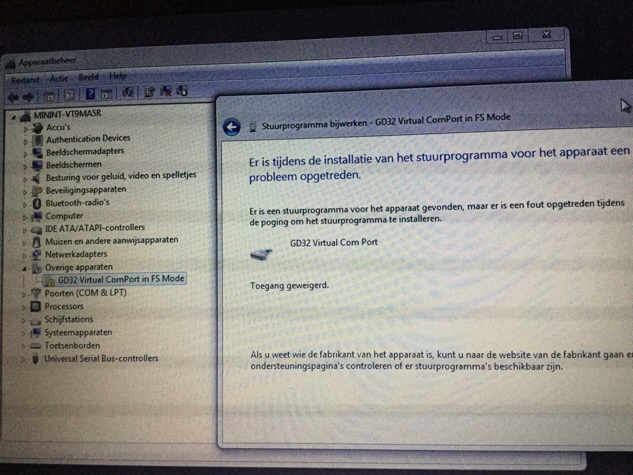

I connected it with a usb cable. It tries to install drivers, but they fail.
Then I downloaded the drivers from the website, located them on my own computer and tried to install it like that.
But then I get the message: access denied.

Then I sort of need to find the com port, unfortunately in 'device manager' I only see this: GD32 Virtual ComPort in FS Mode

I received another mail from the helpdesk with a tutorial on how to install the drivers, but I've tried this numerous times and it doesn't work.
I always get the message they found a driver but they won't install it because the access is denied.

This is windows 64 secure issue, they do not allow install driver without sign.
Better to connect to VoCore2 thought Linux/MacOS, they do not require USBCDC driver.

Or use win10 machine so it can recognize vocore

> using win 7 machine,
unzip this to your win 7 machine http://vonger.cn/misc/vocore2/tools/usb2ttl.zip It will show 2 folders 1 for mac and 1 for window.
when you connect microUSB(vocore2) to USB(win7) you will see GD32 Virtual ComPort in FS Mode, right click, select properties, update and point it window folder you just unziped. Then you will see either COM3 or COM4, which is what you will use to communicate to vocore2 directly.
Once you 'putty' into vocore2 you can do reboot, select f, enter, firstboot -y, then reboot again. do the sequence as many as you need until you see vocore2 wifi again.

Hi cory
Tried this in the beginning.
But it says access denied. And thus I see no com port.
