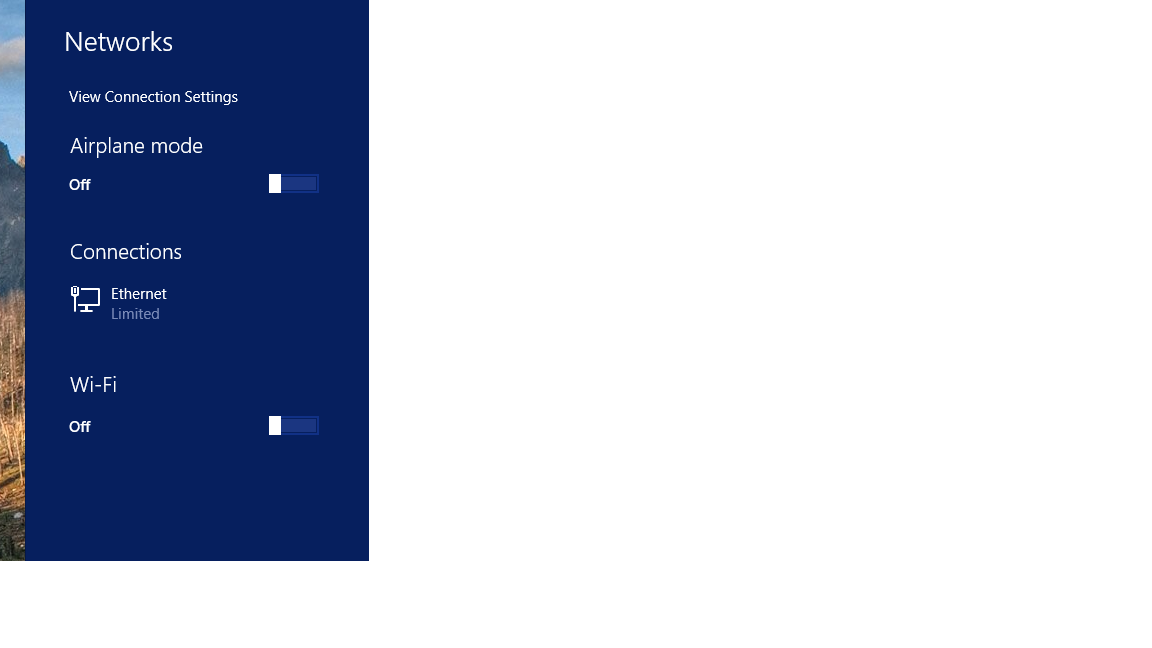

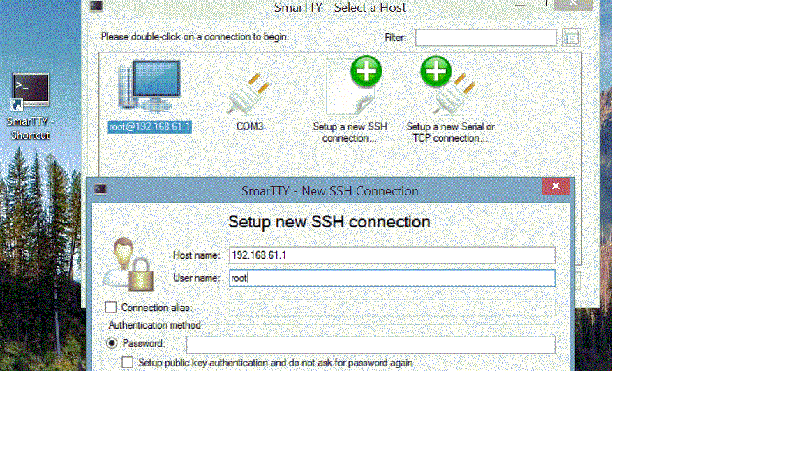

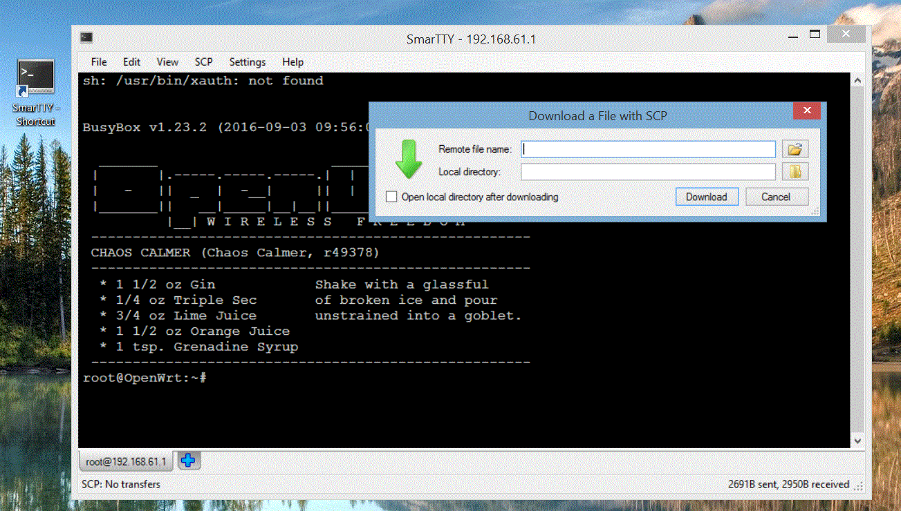

I try picocom, minicom but they are not robust enough to make transfer job easy. This is what I come up with on my win 8 laptop.
1) install smartTTY, it is a full screen interface http://smartty.sysprogs.com/download/
2) I turn off wi fi then I plug in ethernet cable to connect vocore2 to win 8 laptop
3) create connection using vocore2 IP, I just used default setting
4) now you can SCP easily, this is how I import latest image
