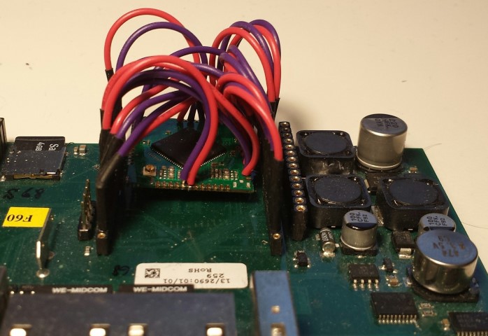

I have wired it to old hardware with 2 Ethernet, and uart1 uart2.

My vocore2 Dock
