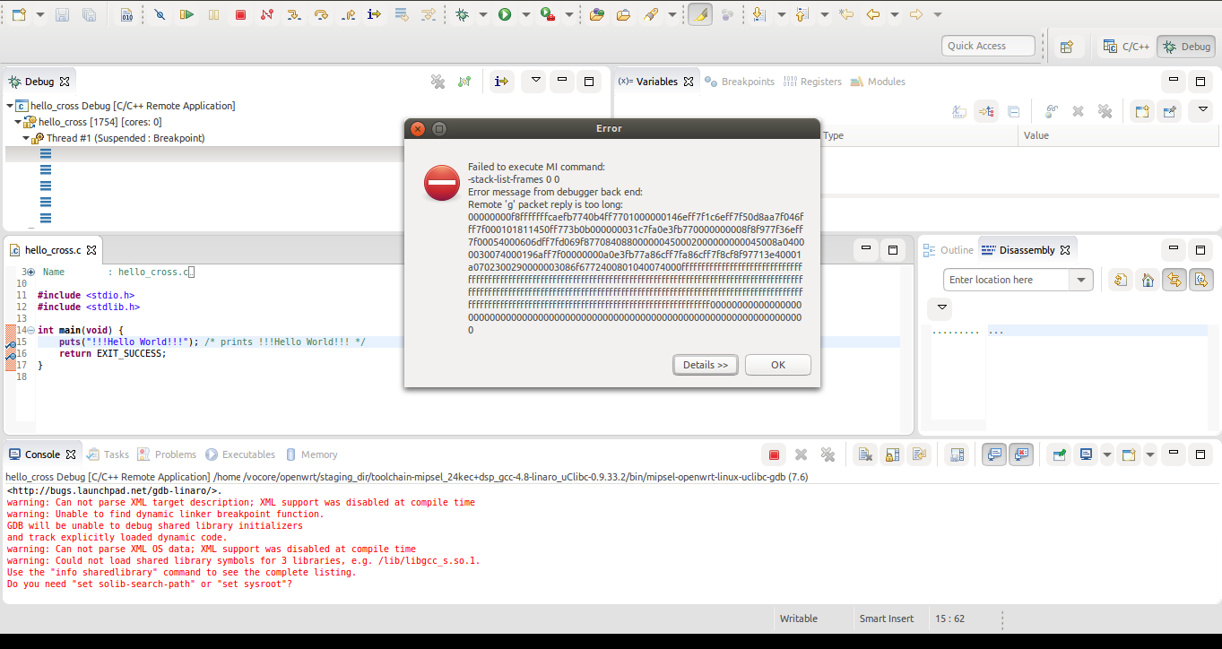

Have someone tried debugging C program for voCore2 and succeed?
I followed this tutorial to setup eclipse:
https://docs.labs.mediatek.com/resource ... clipse-ide
Everything goes fine, untill i stuck with error which goes "remote 'g' packet reply is too long" (see attachment 1)

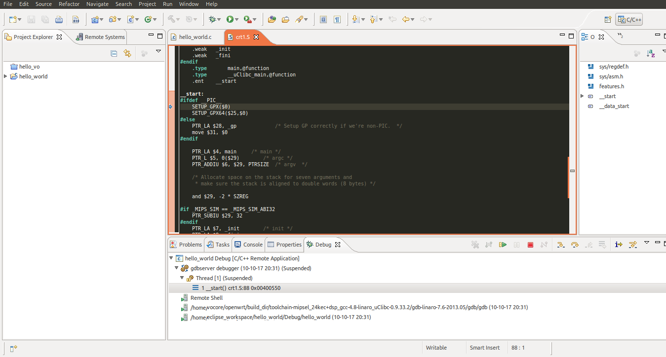

None of set main() breakpoints working, something only stucks at program start(see attachment 2), but i don`t now why debugger set program counter there, when i try to resume program i get mentioned error

Re: C program debugging with eclipse
As I know it is a GDB issue, you need to recompile your GDB with a special flag...(can not remember but can be find at google), then replace the default GDB of eillesp currently using, everything will work.
I have tried this before and get same result when using command line, solved by recompile GDB, later I will update my blog, good luck.
Wow, finally after three days i resolved this issue, thanks for hint Vonger.
So, problem was with missing expat library, if someone will have similar problem this is what You have to do:
1. Install expat library on your host machine
on ubuntu 15.04:
probably only one of these are needed, but don`t really sure which one of these
2. Edit gdb makefile( [openWrt_dir]/toolchain/gdb/Makefile ), we need to add line " --with-expat" to "define Host/Configure" procedure
so it looks like this
3. Rebuild gdb with command
on ubuntu 15.04:
- Code: Select all
sudo apt-get install expat libexpat1-dev
- Code: Select all
(cd $(HOST_BUILD_DIR); \
gdb_cv_func_sigsetjmp=yes \
CFLAGS="-O2" \
$(HOST_BUILD_DIR)/configure \
--prefix=$(TOOLCHAIN_DIR) \
--build=$(GNU_HOST_NAME) \
--host=$(GNU_HOST_NAME) \
--target=$(REAL_GNU_TARGET_NAME) \
--disable-werror \
--without-uiout \
--disable-tui --disable-gdbtk --without-x \
--without-included-gettext \
--enable-threads \
--with-expat \
endef
- Code: Select all
make toolchain/gdb/{clean,compile,install}
