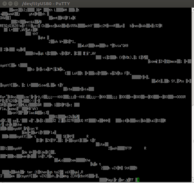

After flashing firmware, Vocore t booting We can see the following in Putty
- 1.png (205.56 KiB) Viewed 20502 times

Looks like there is a lot of noise between the uart line. or maybe ttl output is not exactly 115200.
It should not be software issue, better to use OSC check uart line.
