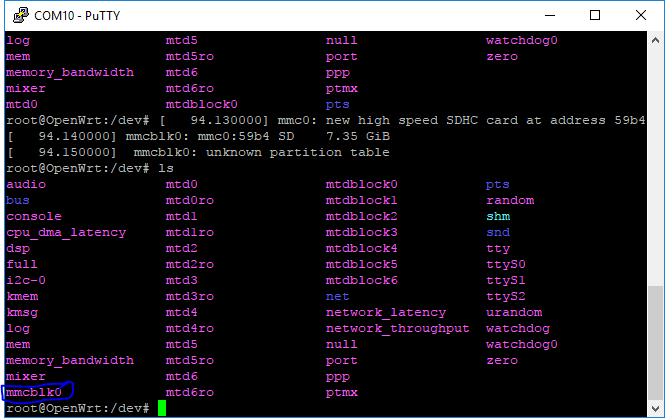

I would like to configure an SD card to expand the root file system so I can install additional packages.
I notice a new directory mmcblk0 appears in dev when I insert the card.

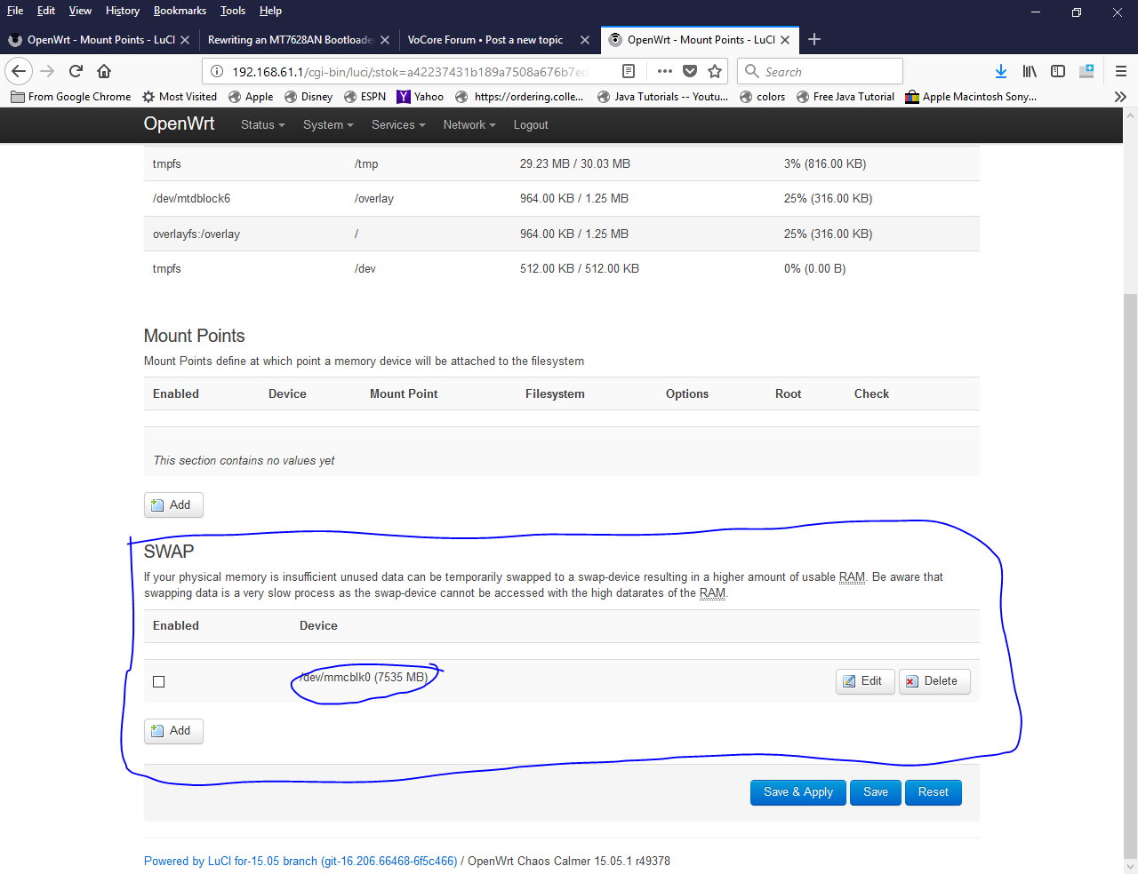

When I navigate to the "mount points" section on the Vocore's web control panel, I see the volume appears in the SWAP list.
interface mount points.PNG (79.09 KiB) Viewed 31565 times
How can I configure the card to expand the root file system? The goal is to allow additional space to install packages and work on projects within the root environment.
