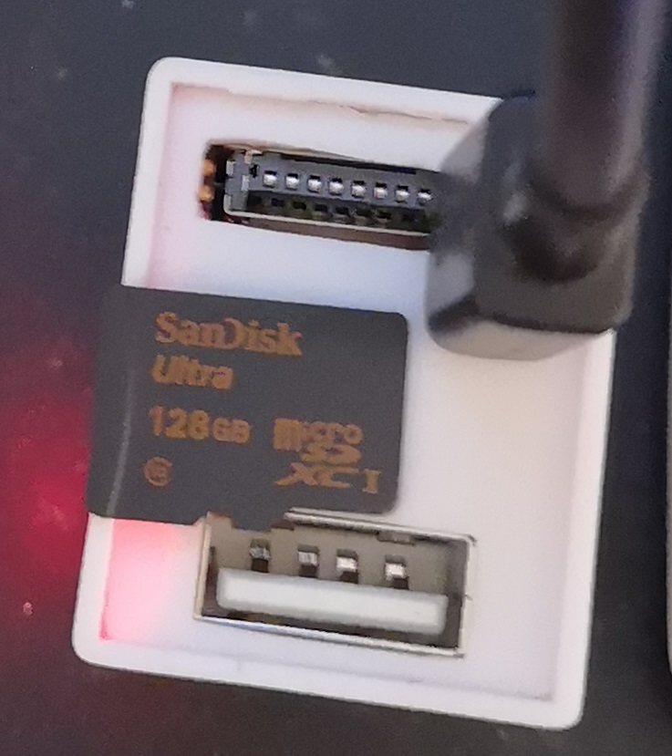

Please see the attached image.
You can also see there the enlarged' CF hole in the case.
The case received had a very narrow cut-out (the CF didn't even fit through the plastic), and that slot was above the internal CF slot anyway
(i.e. even if the CF would have fit through it), it was not aligned with the internal reader)
The CF I used is 120GB one, and last night I reformatted it again as extFAT (just in case), and used it from a different computer just fine.
Then put it in my VoCore2 and as before, 'ls /dev/mmc*' finds nothing.
Let me know how to get the 'tag number' and I'll send it.

- CV used, and the 'new' CF case slot
- CF.jpg (133.06 KiB) Viewed 374205 times

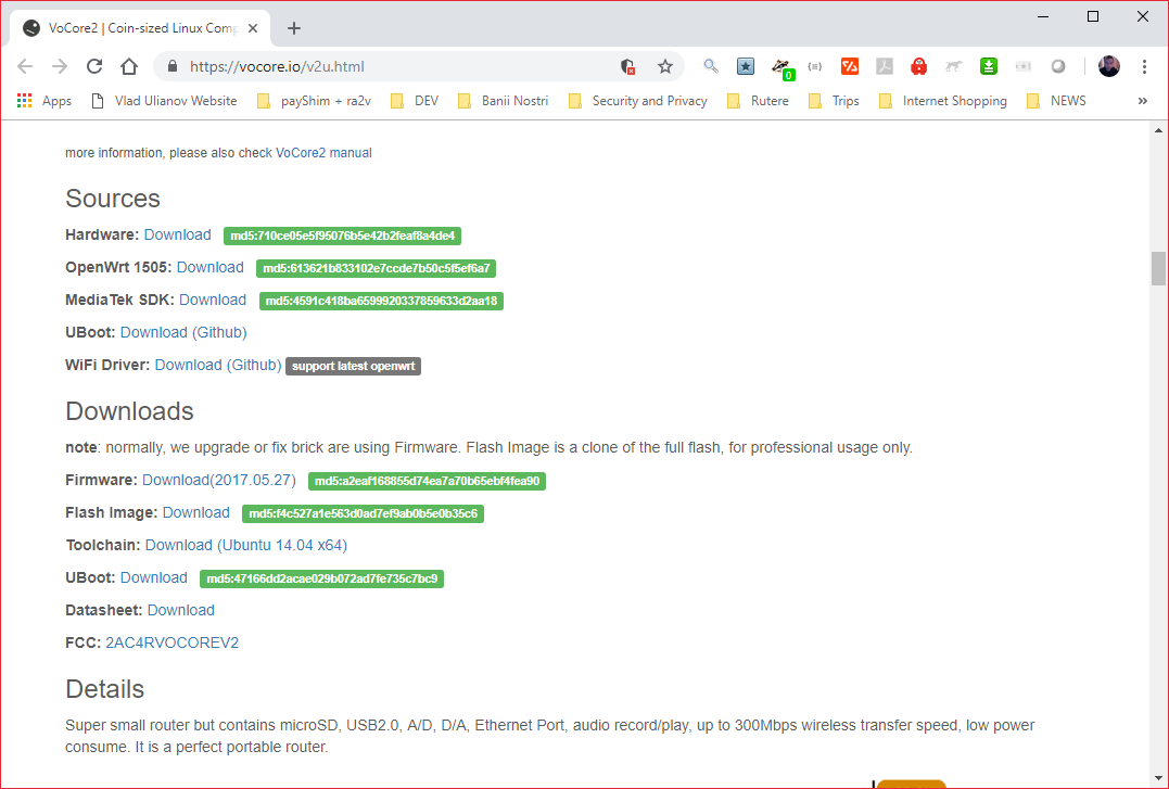

See the attachment, from https://vocore.io/v2u.html.
The firmware is dated May 2017, almost 1.5 years old ...
Do you have any newer one?
- VoCore_page.png (55.98 KiB) Viewed 374183 times
