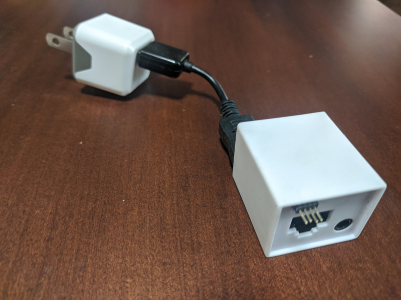

I really like the nice little plastic box that the Vocore2 Ultimate comes in. But I needed some additional connections to it so I added a connector as shown in the attachment.
The pins connect to the Vocore2 at 4 pins next to each other of GND, 3.3V, GPIO37, GPIO38 which gives you 2 IO pins and power and ground. With this setup I first used the ground and GPIO37 to power an OPTO 22 Model 120D10 solid state relay for controlling AC lamps around my house. The addition of a web page shows status and allows editing of cron jobs for timed or manual control.

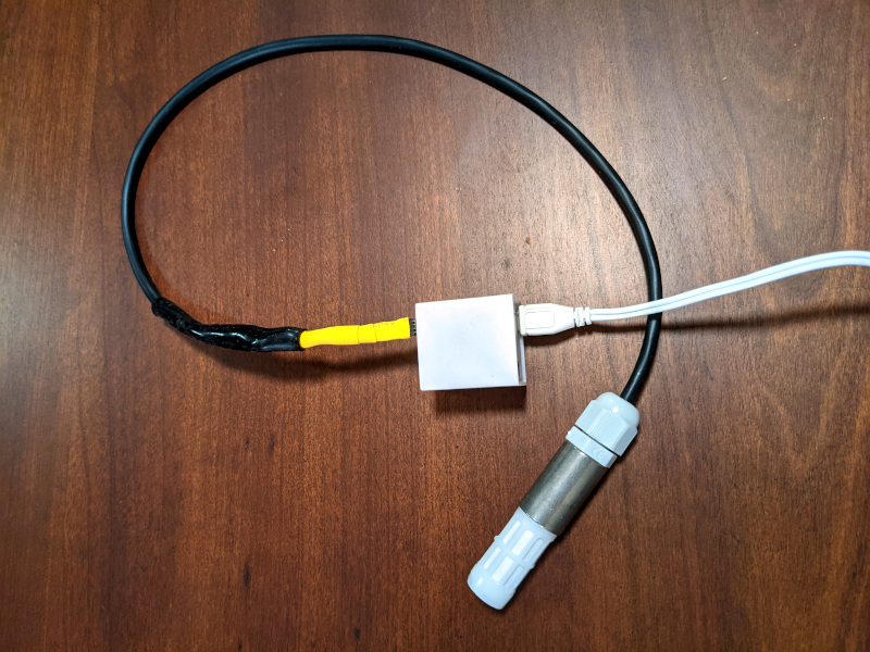

Then I got to looking at the SHT20 in Vonger's blog. I wrote the program below to bit bang the i2c interface. Works nice to show temperature and humidity.

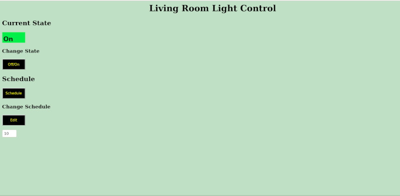

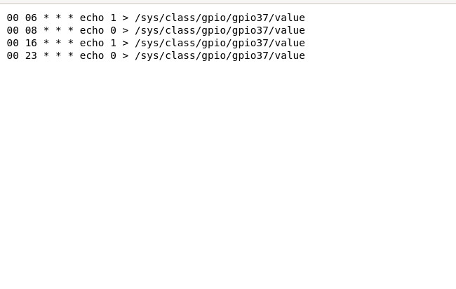

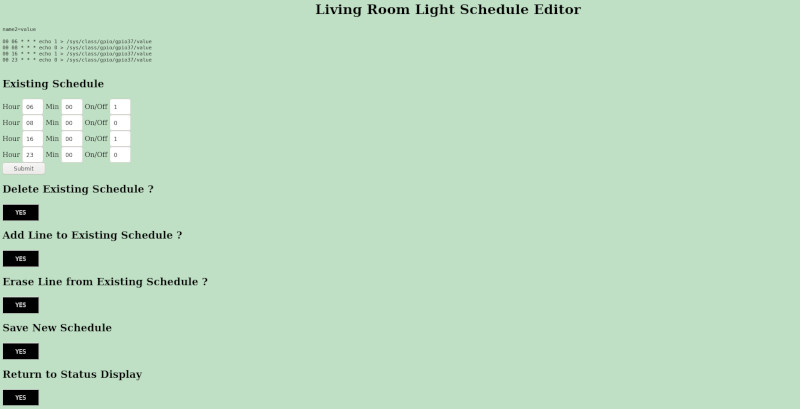

This is the web interface I made to run a light attached to the Vocore2 Ultimate via the SSR I mentioned.
fancy way to edit the cron jobs on a web page
Displaying the schedule shows cron listing
Main web Screen for light control

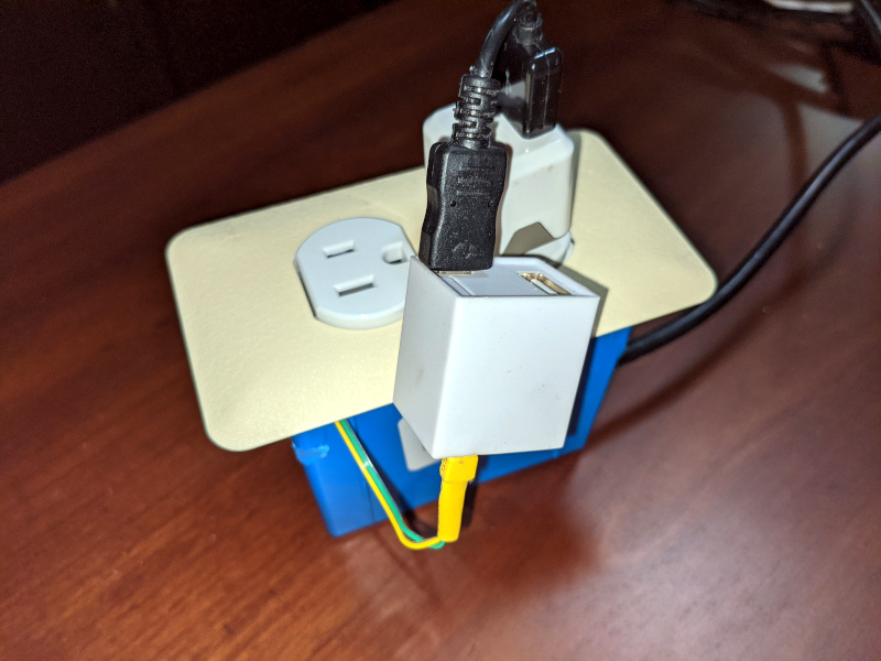

Hardware pictures
power box that controls light. SSR is in bottom of box and controls the top outlet
Humidity sensor that works with code in post
