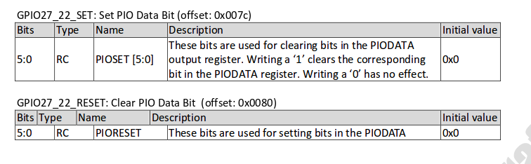

Thanks it works now, but I think I found a misstake in the Datasheet (see attachment).
I think they swap the Description of Set and Clear....
