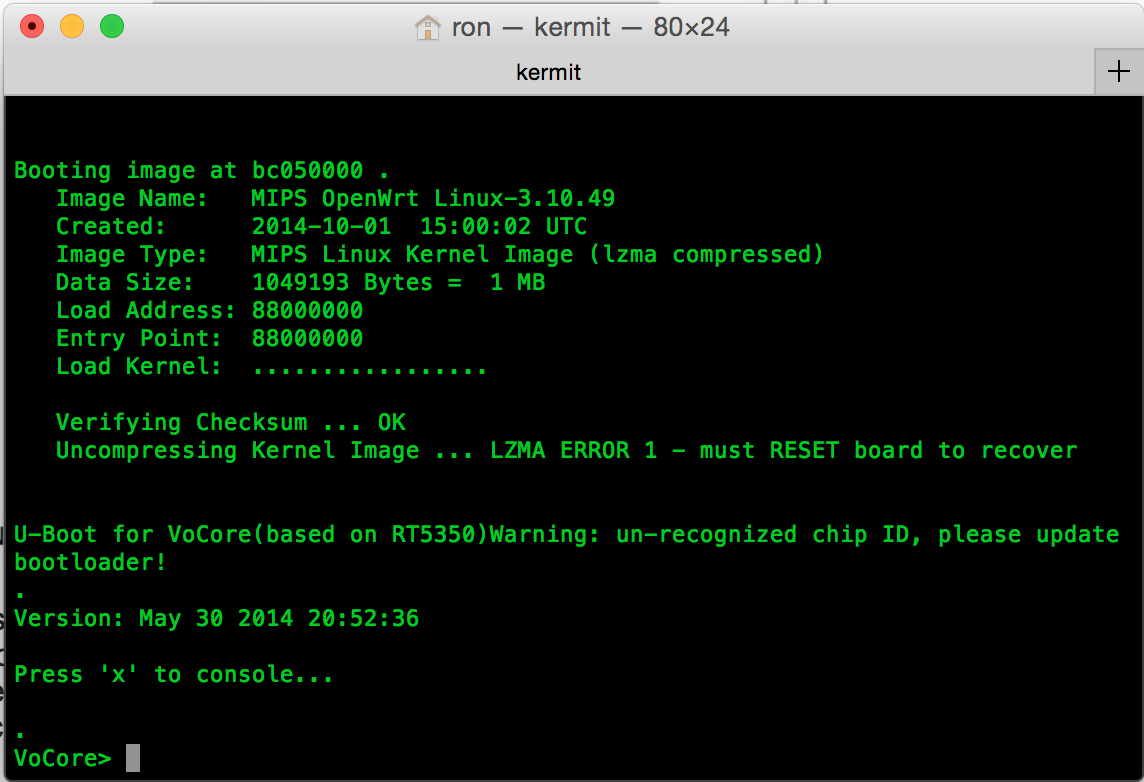

Im posting this in the hope that it will help others with a speedy recovery.
Scenario: You accidentally flashed the wrong OpenWRT image to your VoCore, and it is now stuck in a boot loop. :oops:
At this point, the only way to fix, as outlined here http://vocore.io/wiki/index/id:14 is to use the TTL adapter.
Once I connected via the TTL, sure enough i could see u-boot struggling with the linux partition on the flash, and continually resetting the board.
u-boot error, X to enter console.
Screen Shot 2015-11-27 at 09.49.30.png (111.98 KiB) Viewed 184808 times

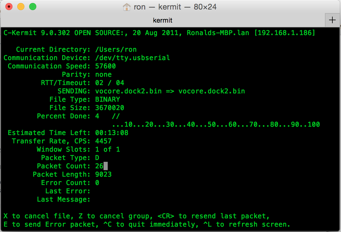

Following the instructions to send the vocore.dock2.bin file (the correct rom for the vocore with dock) i found that the instructions to then write the image to flash from uBoot did not seem to work, and it returned

What i did instead was then type bootm which makes the vocore boot from the file we sent it, from RAM instead of booting from flash
at this point, you can observe the vocore booting OpenWRT, and after a minute or so, the VoCore Wireless network will become avaiable.
I connected to that from my laptop, and used the luci web interface (http://192.168.61.1/ ) to re-flash the correct rom file (vocore.dock2.bin in my case) and waited for the process to complete.
Once it had rebooted back in to OpenWRT, I confirmed that it was able to boot on it's own by observing the console and power cycling the device and waiting for OpenWRT to finish booting, and sure enough the process seems to have unbricked the vocore. at this point I detached the serial console and power and re-attached the dock, and everything seems to be working normally.
Hope this helps someone!

You should see the following screen
Kermit file upload
Screen Shot 2015-11-27 at 09.52.24.png (132.98 KiB) Viewed 184798 times
wait for the process to complete (it can take 10-15 minutes)
